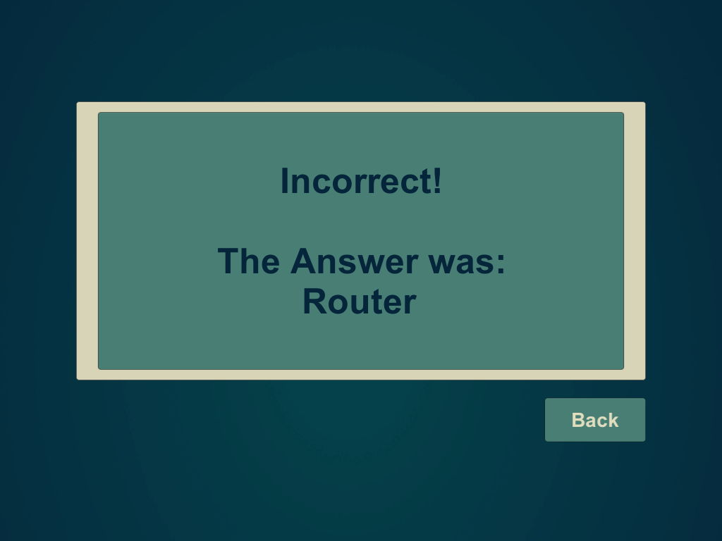

This knock-off Jeopardy game uses questions related to the CompTIA A+ certification and was originally created in Java as a college midterm project, and was re-created from memory using Unity 2017.4.1f1 in an effort to learn C# and Unity Real-Time Development Platform.

      //Default result is incorrect and displays first answer found in query as correct
      result = "Incorrect!\n\nThe Answer was:\n" + row [0];
